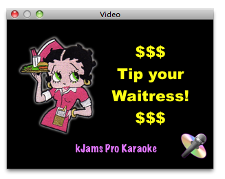

Tip Your Waitress | Customizable "Drink Specials" |
