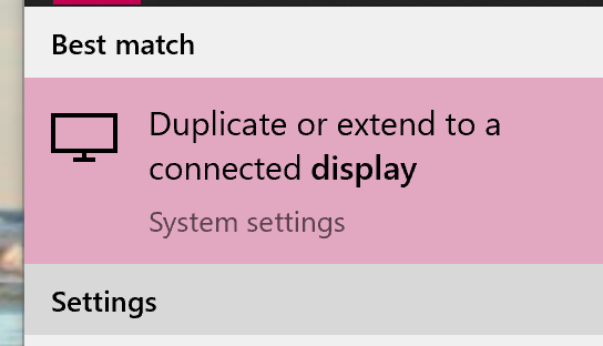

  2. in the search bar, type "display"
    <img src="disp_search.png" width="130pix">
  3. in the menu that comes up with search results, you should see "Duplicate or extend to a connected display", click that

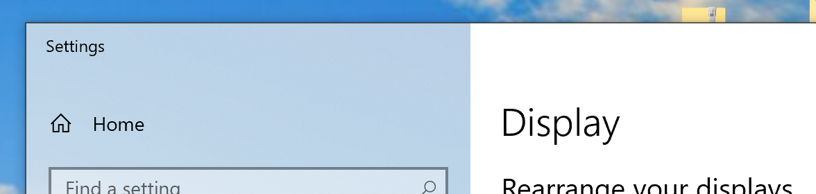

  4. you should now see a window with the small label "Settings" in the top left, and the large label "Displays" in the main area
    <img src="disp_settings.png" width="588pix">

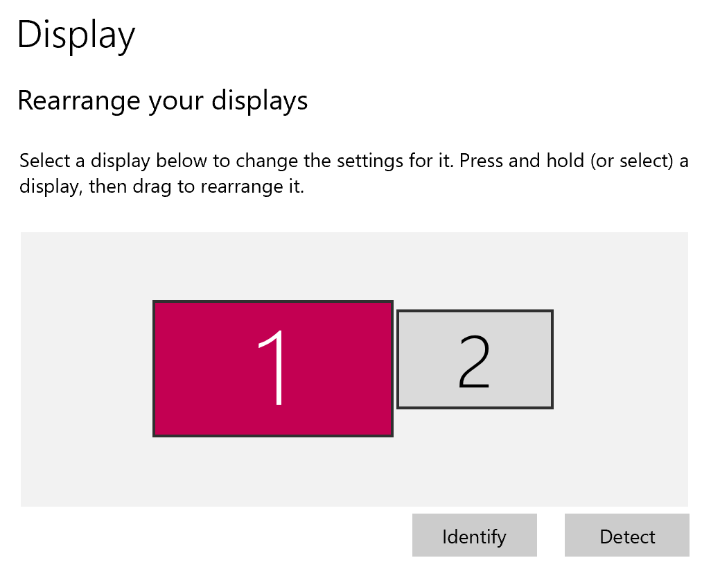

  5. You should now see a section that says "Rearrange your displays", and inside that one or more little boxes, each one being a "virtual screen" representing a physical display
    <img src="disp_arrange.png" width="513pix">
  6. if you do NOT see that section, then scroll down to the section called "Multiple Displays" and click the "Detect" button below that. If you STILL don't see the "Rearrange" section from the previous step, then your monitor is not properly plugged in or turned on or connected or something. You'll have to figure out that part

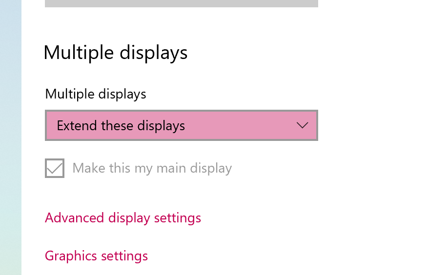

  7. Scroll down so you can see the section called "Multiple Displays". It should show a menu dropdown box with the label "Extend These Displays"
    <img src="disp_extend.png" width="458pix">
  8. if the dropdown does NOT show "Extend these displays", click in it and pick "Extend these displays".

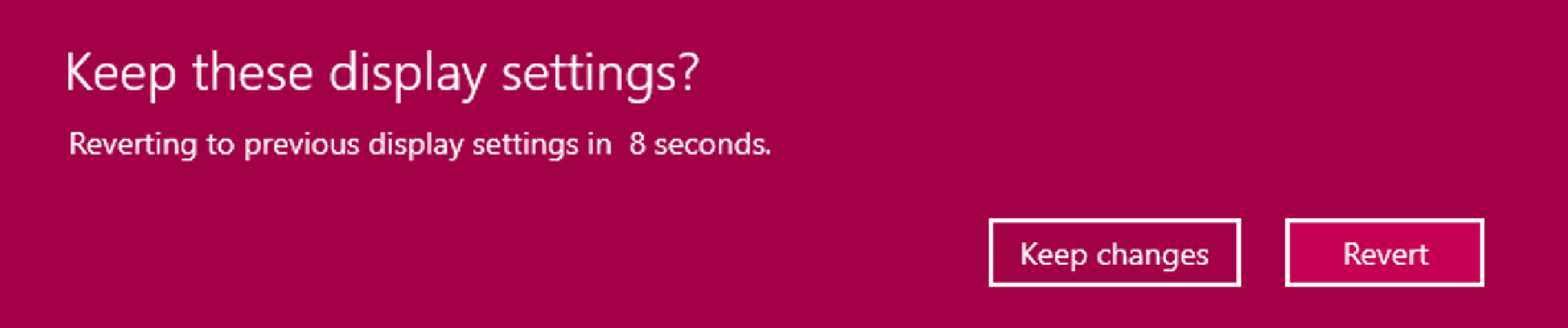

  9. you may see a "confirmation" banner like this:
    <img src="disp_confirm.png" width="664pix">
  10. click "Keep Changes" quickly!

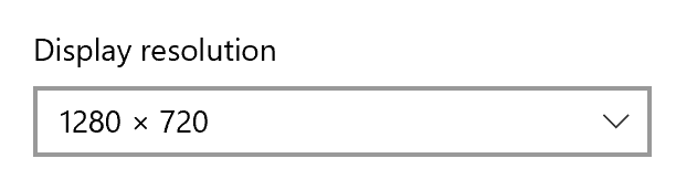

  15. Scroll down to the "Display resolution" section<img src="disp_720.png" width="306pix">
    If you're using 64bit kJams, you can set it to "1920 x 1080"
    if you're using 32bit kJams, make sure it says "720 x 480", or at MOST, set it to "1280 x 720" (but this takes more horsepower)
  16. if it does not say that, click in the dropdown box and pick it. You may need to confirm again.
