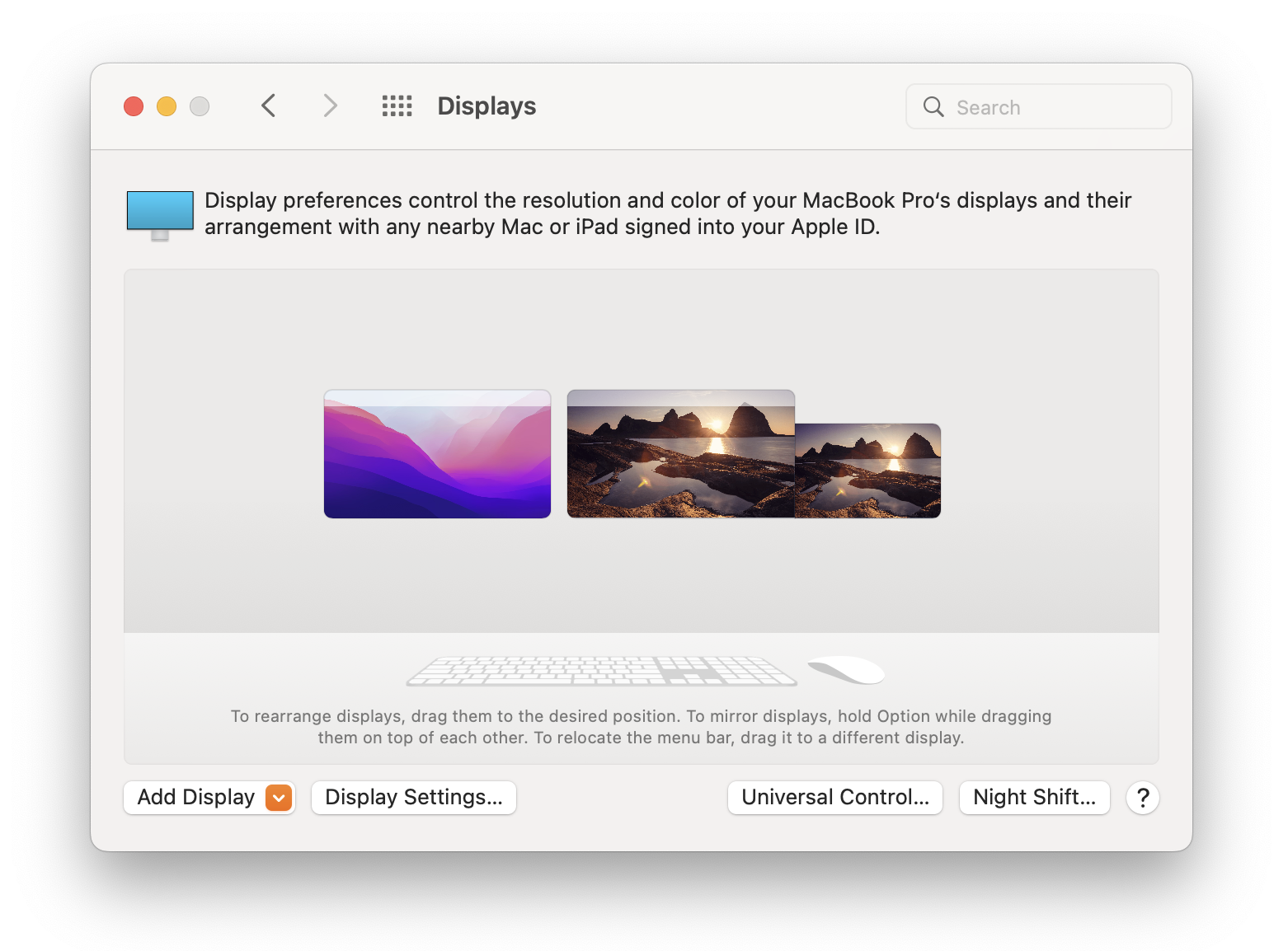

  1. get your second screen hooked up to the computer.
  2. go to the Apple menu and pick "System Preferences"
  3. click the "Displays" icon
  4. click on the "Display Settings…" button at the bottom left of the window, to the right of "Add Display" menu
    <img src="2_display_settings.png" width="781pix">
  5. you should see a list of attached monitors. if you do NOT see your monitor, then your monitor is not properly plugged in or turned on or connected or something. You'll have to figure out that part.

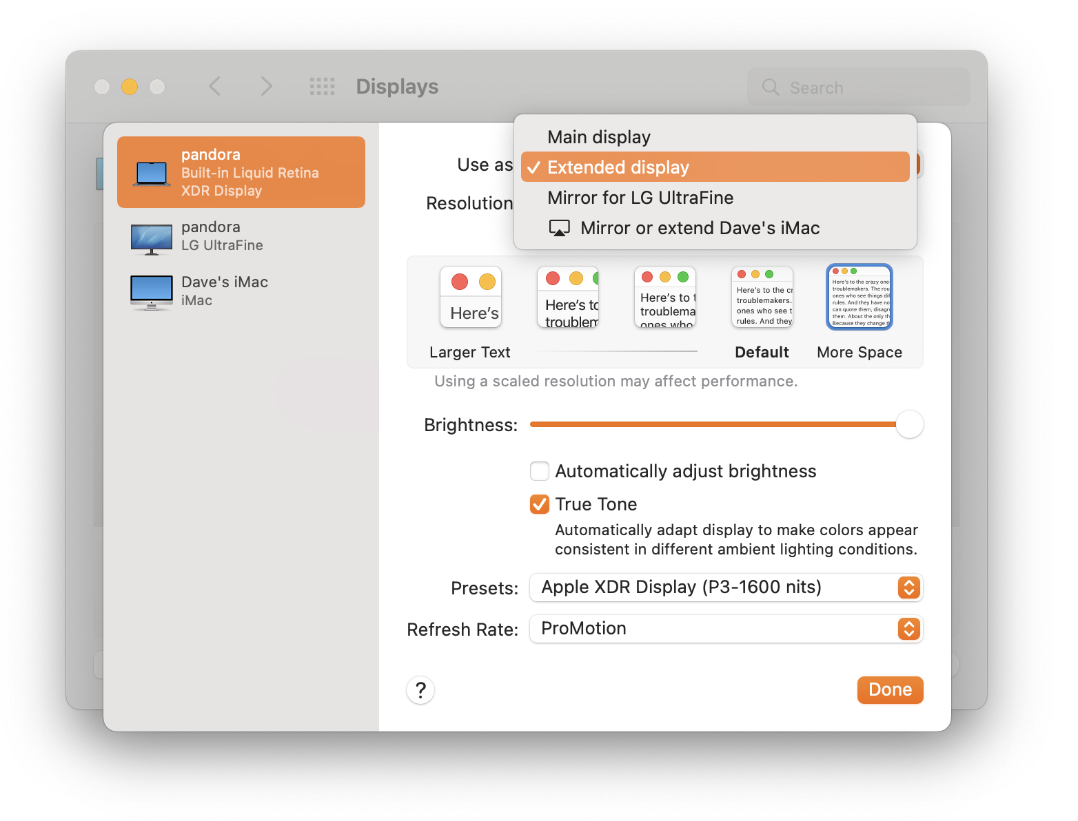

  6. select the secondary monitor you wish to use as extended display
  7. in the "Use As:" menu, select "Extended Display"
    <img src="3_extended_display.png" width="782pix">
  8. hover the mouse over the "using a scaled resolution" tiles, the ones ranging from "larger text" to "more space", as you hover, you'll see the effective resolution of the choice.
    1. If you're using 32bit kJams, pick "720 x 480" or at most "1280 x 720" (although that takes more horsepower).
    2. If you're using 64bit kJams, you can pick "1920 x 1080"
  9. click "Done"
  10. step back and look at the physical arrangement of your displays
    In this example my main computer monitor (smaller) is physically on the right side and the second (larger) display is physically to the left of it (in your case the one on the left would be your TV screen, and may actually appear to be the smaller one).
  11. now go back and look at your Displays in the preferences window. In my example, you can see that the virtual arrangement is backward, the second (larger) screen is on the wrong side of the main (smaller) screen
  12. so i must drag the box representing my second display (the larger on the right), over to the left of the box representing my main display (the smaller one), now it looks like this:
  13. now you should be all set! Close the System Prefs window
