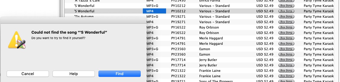

I just opened kJams and updated both of these. I looked at the MP3+G version of 'S Wonderful, and then tried the .mov version, which kJams could not find.
what do you mean? how could you try something that you can't find?
— See attachment.
Re: How does kJams decide a song has been purchased?
ooooh, you mean "tried" as in "tried to play" not "listened to". okay
right. the mp4 and the mp3 have the exact same preview, they're the same preview. there's a bug where if you try to play the mp4 preview it doesn't work. just ignore that, play the mp3 preview, it's the same. note the preview is NOT the video quality you'll get when you actually purchase, but the audio quality is the same.
