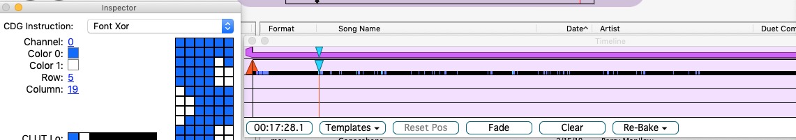

I saw a tutorial which showed a way to edit where lyrics were using an earlier version of kJams that appears to have an integrated editor instead of producer: https://karaoke.kjams.com/screenshots/p ... Timing.m4v It does show a timeline that includes lyrics. But when I try running Producer, I do not see any lyrics on the timeline. Is there an updated tutorial that shows how to get the lyrics on one of those timelines? Fixing glitches, I haven't figured out how to move inspector frames (so I can insert a new inspector frame). Is there a tutorial for that?

the screen shot you're showing is from a CDG file, not from a KTP file.
only a KTP file has lyrics.
Okay, the thing you seem to be referring to is the Inspector *window* (or *panel*), and i now don't know what you mean by moving it. To move a window you grab the title bar and move it around, but you don't insert them either, so referring to the window and saying you want to move it or insert a new one donsn't quite gel in my brain.
Perhaps you are asking how to move CDG instructions in the timeline? go to the time you want and hit the i and o keys on the keyboard. this sets the in and out points of the selection brackets to encompass the one frame you're on. then you can edit->cut to cut it. move somewhere else that doesn't have an instruction, and paste. there you've moved it. note however that generally instructions come in groups, so you probably want to move the whole group, not a single frame.

What I *really* want is to insert a new CDG instruction to fix a glitch. If there is no unused space, I need to move other instructions back (or forward).

Re: Adding lyrics
Glitches can always be fixed in the space provided. it's that one of the existing instructions is wrong, and fixing that wrong instruction will fix the glitch.
It's "wrong lyrics" that can't be fixed that way, that requires re-syncing the song lyrics using TunePrompter, to re-create the entire CDG from scratch.

Sometimes I need to add a frame to fix a glitch, not just change one. And I'd like to add that frame where there isn't a blank frame. So I wish to push other frames aside to "insert" the new frame.

you should never have to do that to fix a glitch. if it worked previously with the given space, you won't need more space to fix it.
having said that you still should be able to set the selection brackets, cut, then move the current time indicator, and paste, to move existing instructions.

Sounds good. Actually, when I had this problem, was when I was trying to fix a misspelling, I shouldn't have called it a glitch.

OH! fixing a mis-spelling is definitely not a "glitch".
to do that you really should just re-create the entire song from scratch, replacing the entire CDG file. it's not worth your time to attempt to hand-craft a newly spelled word using CDG instructions. it's like writing program in assembly language by typing in HEX, as opposed to writing it in python.
