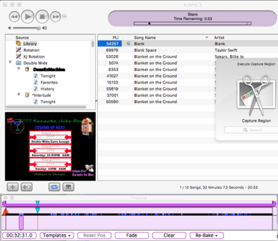

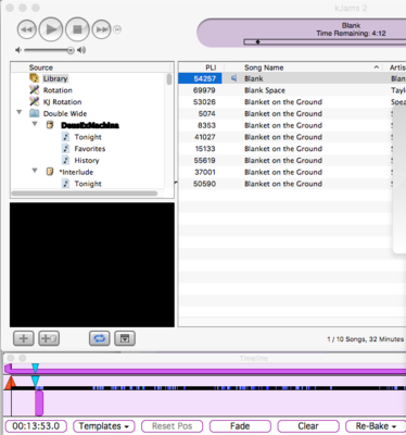

Anyway, it's hard to tell which version I am dealing with because for some reason kJams is no showing the relevant assets in the Preview window, which is remaining blank (black).
As you can see, the actual assets and data entries are still there:
This is an old bug that I thought was fixed.

I'm talking about the no drag and drop being related to the assets not showing up in the video window.
Give me a sec to reboot and sort that part out.
Re: kJams destroying Rotation screens
Yup, rebooting allowed the assets to show back up. Weird.
