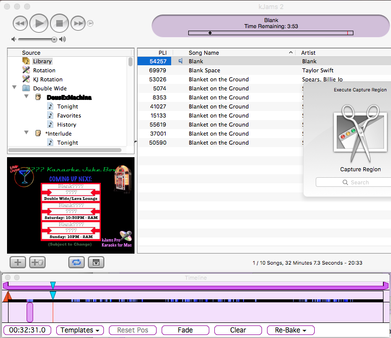

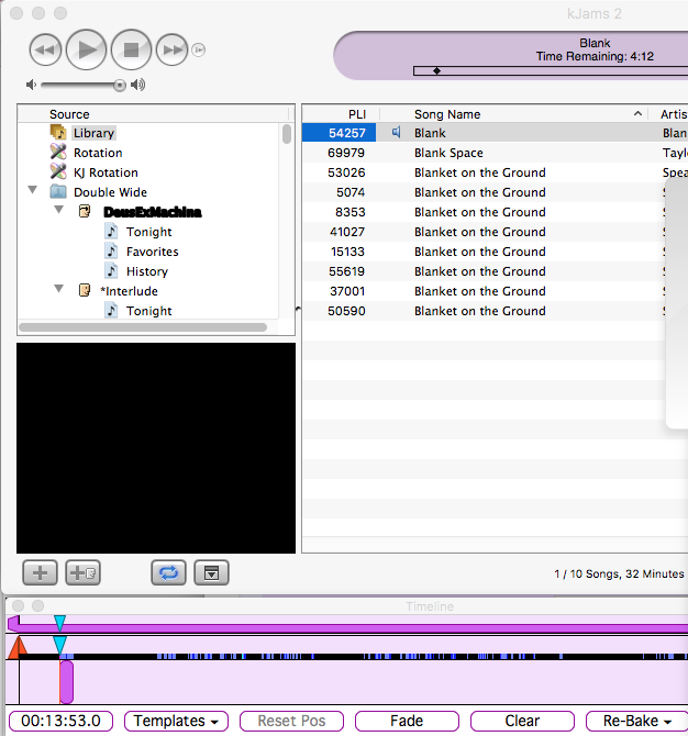

Anyway, it's hard to tell which version I am dealing with because for some reason kJams is no showing the relevant assets in the Preview window, which is remaining blank (black). As you can see, the actual assets and data entries are still there: This is an old bug that I thought was fixed.

I'm talking about the no drag and drop being related to the assets not showing up in the video window.
Give me a sec to reboot and sort that part out.

Yup, rebooting allowed the assets to show back up. Weird.
But wait. Weird. Certain text assets are not showing up. And the Inspector Window doesn't show the currently selected asset.
It shows the same text asset no matter other text asset you click on, until you click on a pic asset, and then on another text asset, at which point it updates, and then doesn't again, until you click on a pic asset again.

Okay, so… everything is fixed. I think at some point the data assigned to the tags ([sngr], etc.) got hardcoded to their values, replacing entires like [name][+sgr] with Blank???? and [SNGR] with ????.
Not sure how this happened, perhaps during one of the upgrades that complained about the changing of the rotation screens, but I haven't touched either the Rotation screens themselves, or even Producer, in months, so it was nothing I did on my end.
A/k/a no steps at this point.
That said, not having the tags appear on the Video Window, but just having them replaced with "????" even while their actual values are in the Inspector Window, is confusing and makes editing the ShowScreens difficult, since you can't tell which entires are what without clicking on them and checking the Inspector Window.
