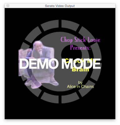

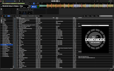

FTR, using my old SunFly presets, Serato reads kJams exported video just fine:
Sorry, running it in demo mode on this machine
H.264
Best
frame rerodering
multipass
720p
112kbps AAC audio

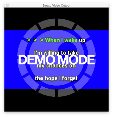

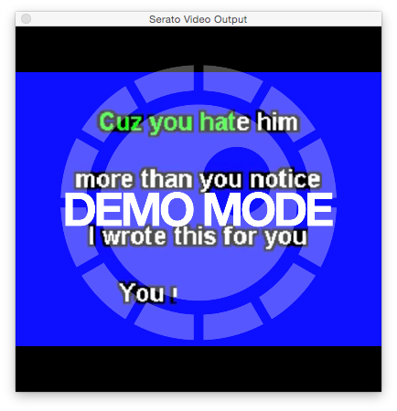

As this was done on a homemade track, I also did one from a commercial CDG, same settings. Worked fine:
THM−P0511-02 - Fall Out Boy - Grand Theft Autumn

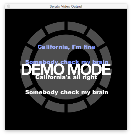

I also tried doing one at QVGA (320x240) a/k/a/ CDG size:
Everything works fine.
