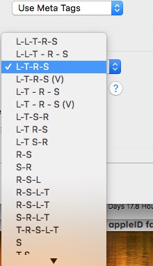

It looks as though I need to change this from the default which I haven't touched:
Screen Shot 2018-08-27 at 7.19.14 AM.jpg (24.43 KiB) Viewed 16216 times

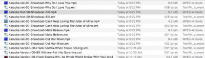

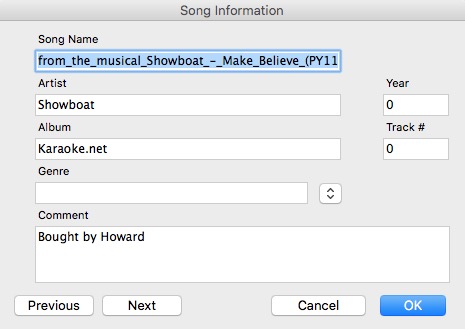

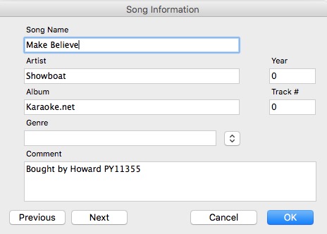

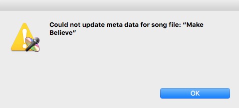

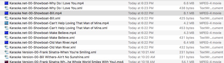

I just got the error again with a couple of songs. Here are some screen shots:
