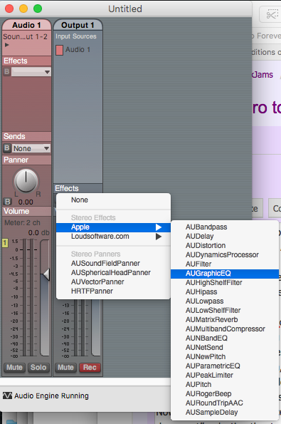

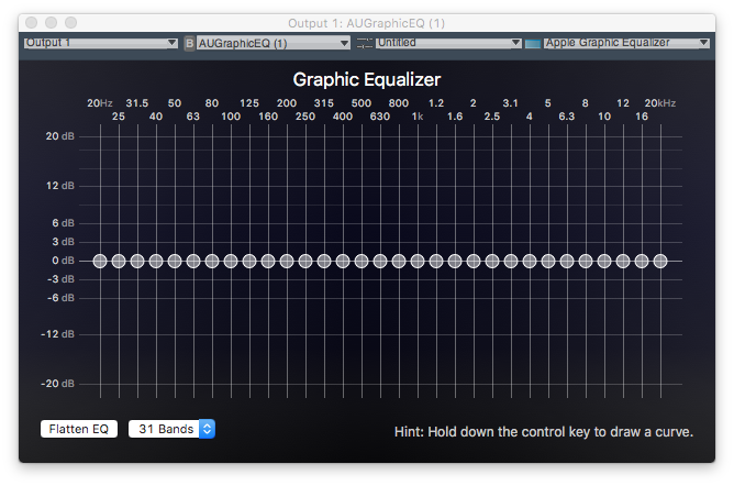

FTR, Logic is completely superfluous here. You can route your audio from kJams directly into AU FX plugins like EQ without it, using Loopback/SoundFlower and AU Lab.
1) Set System Volume to the maximum level.
2) In System Preferences, select the “Sound” panel, followed by the “Output” tab. Select the desired Soundflower or Loopback auto out from the Output list.
3) In AU Lab, select Soundflower or Loopback from the “Audio Input Device” pulldown menu, and then from “Audio Output Device” menu select whichever output you want, probably “Built-in Output”
4) Click the “Create Document” button at the bottom of the screen
5) In the “Output 1” column, click the “Effects” dropdown and select “AUGraphicEQ” from the "Apple" submenu. Your new system-wide equalizer will pop up in a new window! If you want to save EQ presets, when satisfied with the EQ settings, hit Command+S to save the EQ settings file wherever you'd like.
In AU Lab preferences from the AU Lab menu, click on the “Document” tab and click the radiobox next to “Open a specific document”, and select your saved .trak EQ file
