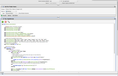

I have Perrin and Quicktime 7 installed on my MacBook Pro running Maverick
In the window 'Ask for Finder Items' I have in 'Prompt'
"Choose a file or folder of images to display behind Video window:" including quotes
Then in the drop down box below I have Desktop selected
And 'Type' I selected Files and Folders
I have not ticked Allow Multiple Selection
Then in Run AppleScript I've pasted your code

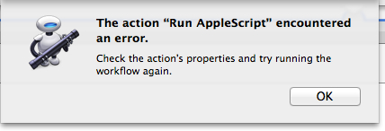

Then I hit Run and I get this window
Then I hit OK and a desktop window opens. When I select a 252kb jpg from that window I get this pop up
Re: Background Video's
1) Post a screenshot of the entire Automator window.

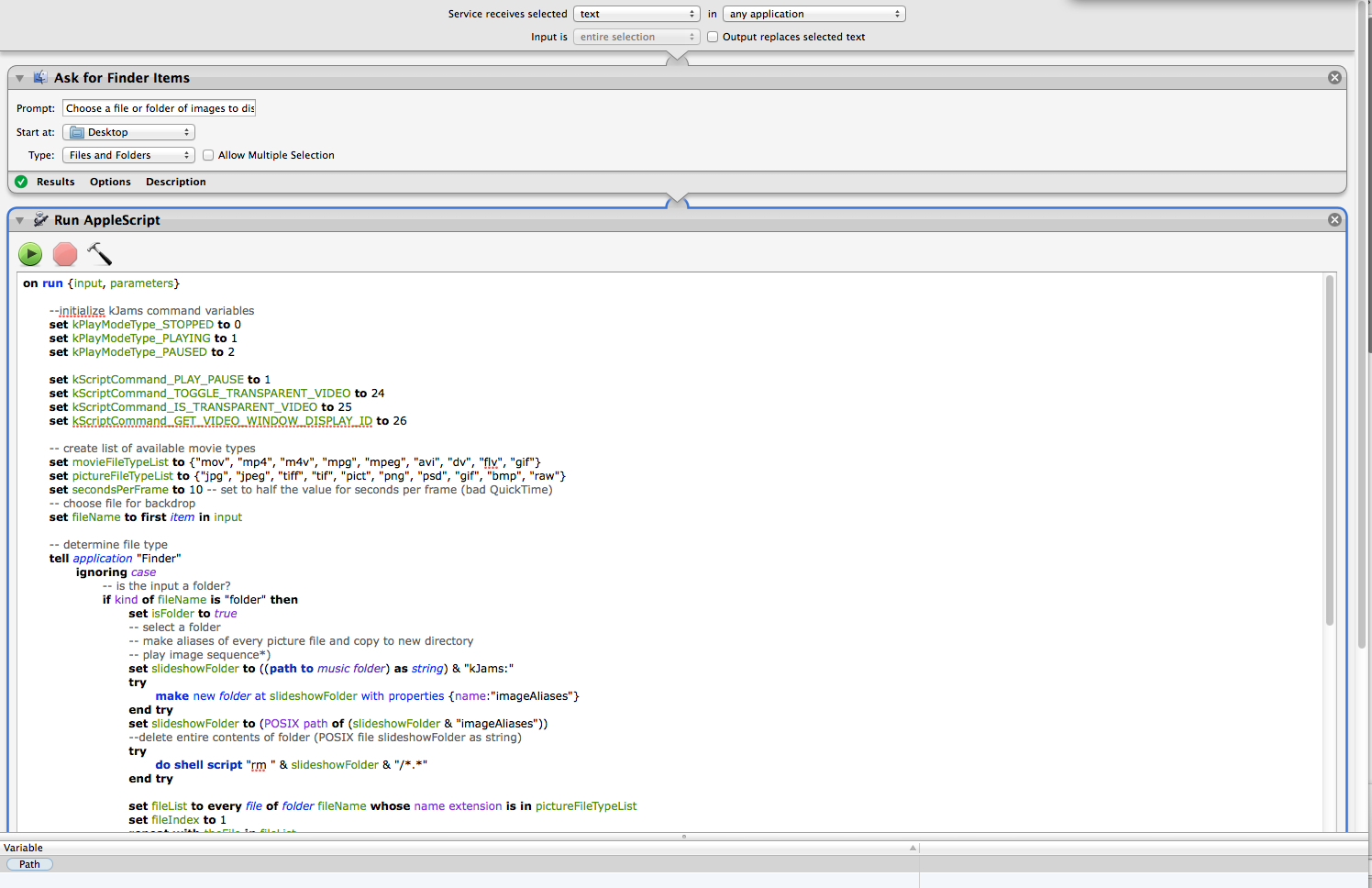

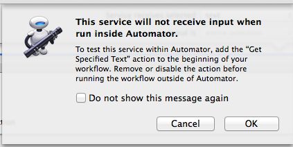

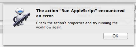

I hadn't seen that post about replacing the text
With the new text in place I now get this pop-up
Here's the screen shots
Again, as I wrote, the action should receive "no input", NOT "text", and the selected application should be the version of kJams you are using, not "any application".
That is why you are getting the first error.
Also, what version of kJams are you using? It must match the version called in the script. If you are using Pro, it should say 'tell application "kJams Pro"' in the script. Likewise, if you are using kJams 2, everywhere it says "kJams Pro" in the script, it should say "kJams 2".

You just have to click the "Service receives selected" pop up and set it to "none", and select kJams in the Application pop up.
