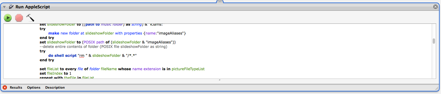

Okay, part of the problem is that Apple changed the default behaviour of Automator in response to shell script errors. So to stop the script from bailing in the newer versions of OSX, change the line that looks like this:
do shell script "rm " & slideshowFolder & "/*.*"
to look like this:
try
end try
I also suspect there will be issues now that Apple has screwed around with how fullscreen works, so I will have to test further. But so far that fixes the hang.

1) Post a screenshot of the entire Automator window.
You should have:
Service receives [no input] in [kJams 2 (or Pro)]
Input is [greyed out] with unchecked Allow Multiple Selection
2) You don't need quotes around the prompt.
3) did you replace the text I discussed in my last comment?
It should be:
You should have:
It should be:
on run {input, parameters}

I hadn't seen that post about replacing the text
With the new text in place I now get this pop-up Here's the screen shots

Again, as I wrote, the action should receive "no input", NOT "text", and the selected application should be the version of kJams you are using, not "any application".
That is why you are getting the first error.
Also, what version of kJams are you using? It must match the version called in the script. If you are using Pro, it should say 'tell application "kJams Pro"' in the script. Likewise, if you are using kJams 2, everywhere it says "kJams Pro" in the script, it should say "kJams 2".

You just have to click the "Service receives selected" pop up and set it to "none", and select kJams in the Application pop up.
