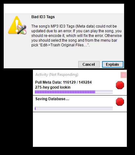

I have some help from a tech savvy friend and he took a screenshot of the error.
We started adding to the library from an external USB drive.
It ran overnight and appears to have locked up.
We clicked the explain button, and it only gives the windows default "program not responding" message.
From there we selected wait for program.
We did not click the cancel button, as we did not want to loose the progress we have made with the data import.
Thank you for your assistance!
Please advise on what our next steps should be.
Please see attached screenshot.
Dave I think I will delete the Kjams trial program and clean up my external drive and start over as it looks like I have 3 duplication of my songs in the Kjams library, would that be best? would I have to re-register on this forum if I do so

the "explain" button is supposed to lead you here.
to start over, you must throw out the "kJams" folder located in your user's Music folder. emtpy the trash / recycle bin before you continue.
do this:
trash the "kjams" folder
empty trash
run kJams
quit kJams
--> now there's a new "kJams" folder
copy the files from the external drive into the "kjams" folder (in a new folder, do NOT place inside the "kJams Music" folder)
eject / remove the external drive so as not to confuse you
run kjams
file->add to library
pick the folder you just copied
pick "reference" (NOT copy)
