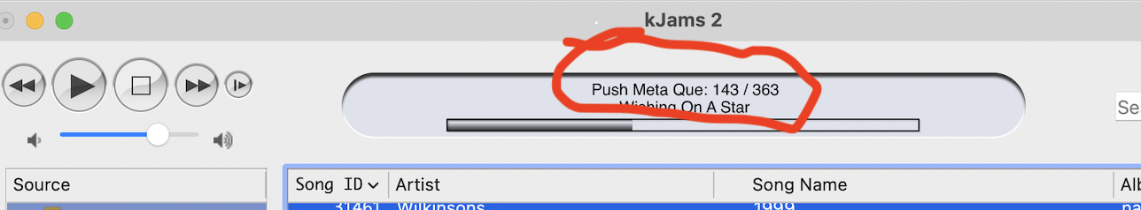

"Push meta que"
is the activity info in the microphone field regardless if it is pushing file names or meta tags.
The command work with different speed so i guess it is a difference.
(But i can't understand what is happening. Pull meta, changes file names. Changing tags, non saved, and then restore by pull meta, saves the new tag ... i get back after next update.)

My issue is, the same info shows regardless if i push meta or filenames.
When i try to clean up thousands of files (name and meta) it is helpful to know what kJams is doing.
Ie, the frade "pushing filenames" never shows"

Oh. I see. yeah, sorry.
the Queue holds a mixed bag of whatever needs to be pushed, whether it is just meta (the xml or xattr sidecar file), or file names (includes meta), or tags (includes filenames and meta). any given "push" activity may contain all 3, so it's not like one activity is of only one type.
