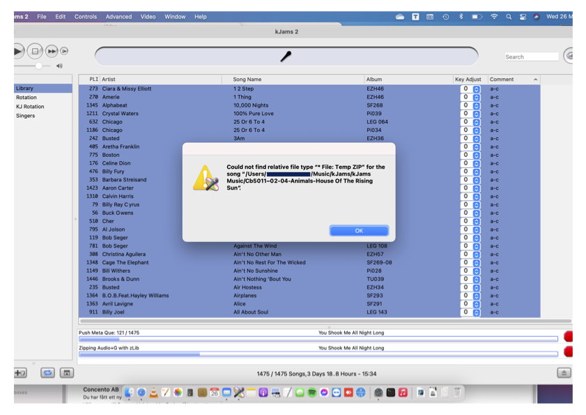

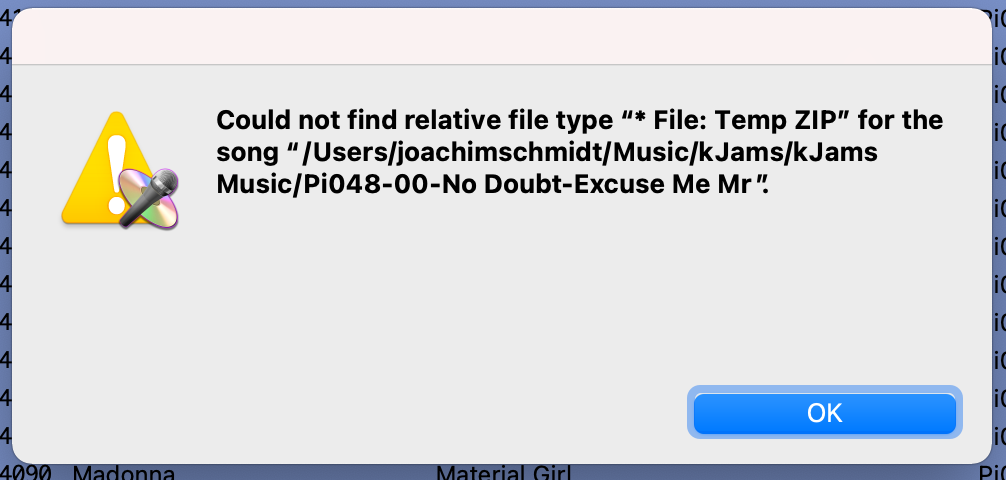

Tricky.
i pulled a folder with 900-ish zipped cdg+mp3 and added them (since now i only have unzipped files).
highlighted some and repeatedly pushed meta.
different files, sometimes none of them, one or several brought up this alert.
(All files unzipped without error with Archive Utility)

Re: Zipping when pushing meta data
The "Could not find ..." warning is strange. I use "Refernece" for all files. kJams/kJams Music folder is not used. Nothing to look for there.
