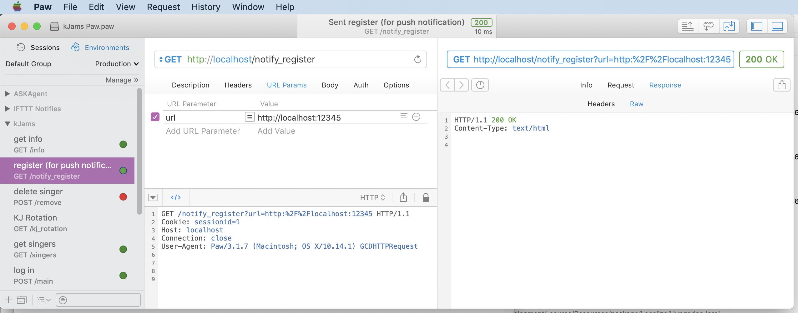

for my testing, i use a tool called "Paw".
it's unit test looks like this:
when i ask it to output that as a cURL command, it shows this:
curl "http://localhost/notify_register?url=http:%2F%2Flocalhost:12345" -H 'Cookie: sessionid=1'

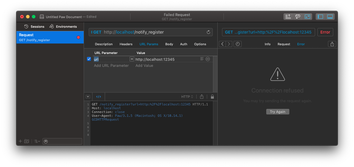

Yeah, you and I have discussed Paw before (as well as POSTman).
I am not sure how you have kJams set up, but unless you have the server listening on the default loop back port, not sure how a call to just "localhost" gets through to kJams in the first place.
Certainly doesn't on my machine (since that is the first thing I tried, skeptical though I was).
I even tried explicitly specifying a GET (since cURL defaults to POST, I think) and it got me nowhere.
Even on Paw:

So, I tired with Paw what I had thought would work with cURL, namely, http://localhost:12345/notify_register with parameters, url=http://localhost:12346 (note the change in last number from 12345 to 12346) on the understanding that since, in prefs, I still have kJams listening on 12345, that to send it a request to send notifications to an ADDITIONAL client, I have set a new port.
This seems to work on Paw, but fails with cURL via Terminal.
Thus my original question vís-a-vís what cURL statement you had been envisioning.
Also, the Paw session just crashed kJams, so there's that!
Re: Triggered scripts
Scratch all that, I read through that too fast (plus the window was too small) and I missed the --header switch. Adding the --header switch, and passing the 'Cookie: sessionid=1' header was the trick. At least so far using the command:
curl "http://localhost:12345/notify_register?url=http:%2F%2Flocalhost:12346" -H 'Cookie: sessionid=1'
eliminate the error that cURL was throwing back in terminal (and thus in scripts).
So now onward to actually get it to work and listen on 12346 (which for me is probably going to be a far bigger feat!) and respect my authority when I tell it to do something!

yes, my server is running on Port 80, which is the default port, so you don't have to specify it, it is assumed if you don't specify any port
