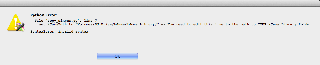

Dave, I just saw you added the Python script! Awesome, but how do I edit it to change to my custom path? I run everything off an external drive. My kJams library is on there. I tried both "/Volumes" and "Volumes without the slash..."
Thank you!
def copy_singer():
cmds = kjams.enum_cmds()
set kJamsPath to “/Volumes/DJ Drive/kJams/kJams Library/" -- You need to edit this line to the path to YOUR kJams Library folder
