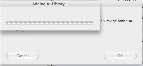

Re: Not able to add to library
Open kJams
Wait for activity window to stop showing progress bars
Hit command/o
Navigate to a track and hit choose
when next window opens hit reference
A window opens saying adding to library with another window underneath that I can't read
The window does not go away ever

where, exactly, is said track? i bet it is on the desktop. and is it exactly ONE track, or did you pick a folder?
you can't reference from the desktop, you can only "copy/move". that's probably what that dialog is saying. You can't do that because 90% of people think that reference means copy, so they "reference" it then throw out the file on the desktop, throwing out their only copy. but the dialog should come up in front, not behind, that is a bug.
Your correct. I normally have tracks on the external HD on the computers I leave at the venues but this was a track I was working on at home and the track was on the desktop.....it's habit clicking reference
