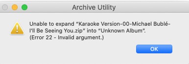

I boot to Mojave to run kJams. But today I used Spotlight under Catalina to do a search and got a result which found an error within a Karaoke song. Googling, one answer I found is that the file is zipped with a 32-bit zip program.
Does that make sense? Will we have to convert our songs when before we run kJams under Catalina? Or was that answer messed up?
Screen Shot 2020-03-15 at 6.46.22 AM.jpg (17.42 KiB) Viewed 23227 times

did you test if you could unzip that exact same file under Mojave?
i expect the zip file is corrupt either way. zipping / unzipping a file is unaffected by the bit-depth of the app that did the compression / decompression.

I'll check. Hmm, I went back to Spotlight for that same search and got that message immediately without having a "find". Pulled out a different utility to find where the file is. I could open a different Karaoke zip file with Catalina.
Re: Zipped songs under Catalina
I booted to Mojave and double-clicked on that song and a few others. They all unzipped. Went back to Catalina and got that error with those songs.

send me a zip file that behaves differently between Mojave and Catalina, thanks

you're right, catalina can't unzip files that have roman diacritics, when zipped by an OS < Catalina. crap.
i'll have to deal with that!

i don't know if apple will fix it. rest assured i'll have some fix for it so you won't have to worry

It may be that Apple has already fixed it. After I upgraded to Catalina 10.15.4 yesterday, I opened a few zipped songs successfully.

you are correct, this problem has been fixed by apple!
