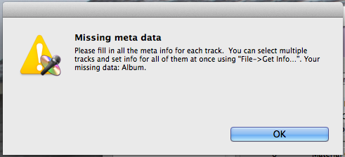

when I tell it to rip, it tells me to please select all meta info for each track
actually, it says:
Please fill in all the meta info for each track. You can select multiple tracks and set info for all of them at once using “File->Get Info…”. Your missing data: XXX
So, what is XXX? Maybe take a screen shot.

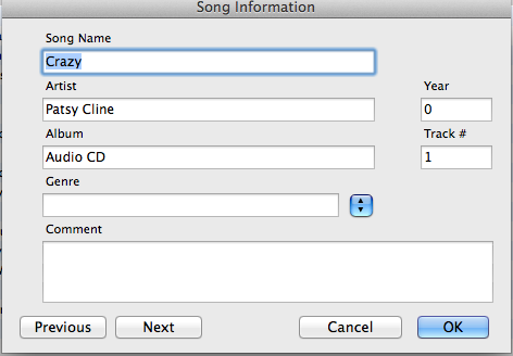

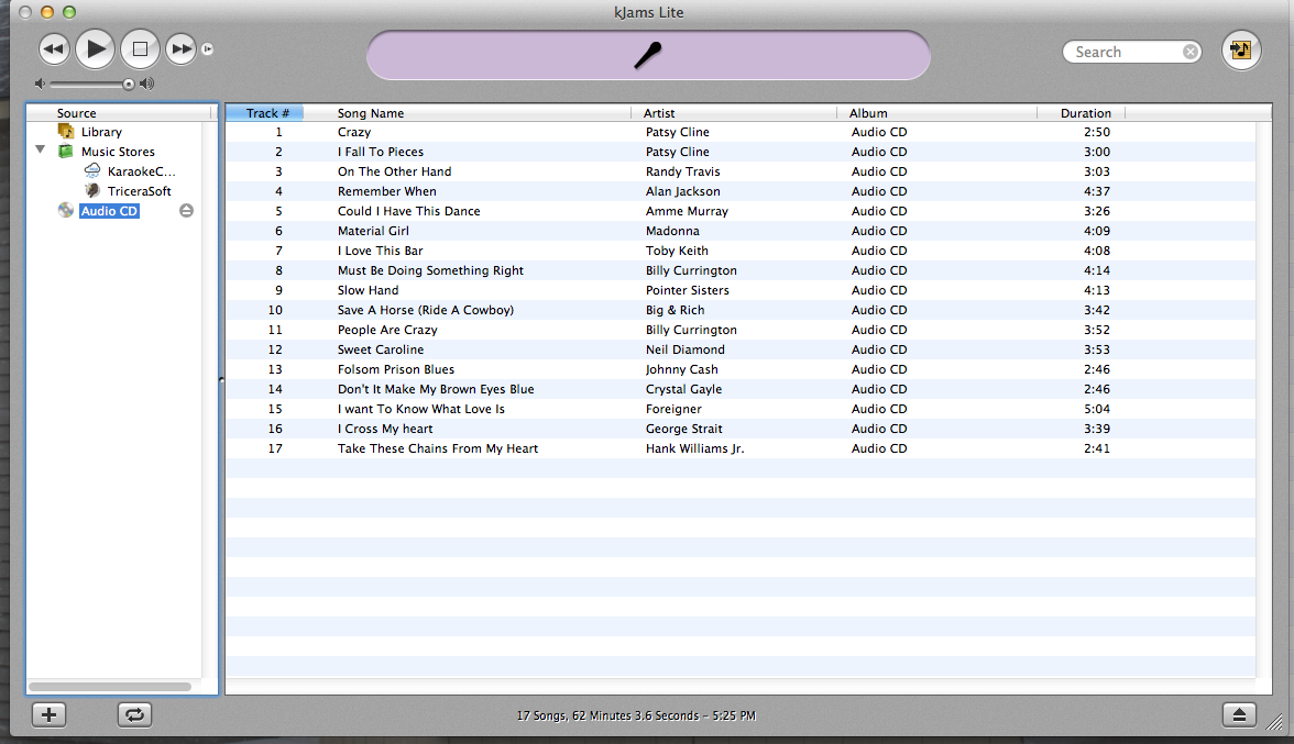

I added the screenshots below. I put in the disc and go to"get info" and the info seems to be there but I still cannot get the words on my screen , just music and it still says it's missing the meta data.

i was asking for a screen shot of the dialog showing XXX, that's the part i needed.
but i'm guessing it said something like "Your Missing data: Album Name"
"Audio CD" is NOT a valid album name. please enter the name of the album.
get info on the CD icon and type a real album name
that will change them all on the disc at once

I think this is the screenshot you want but I am not sure what to name the album. I got it from Karaoke WH.com and chose the songs randomly. It says MyCDG001.

yep. it even says the "Album" needs to be set to something (other than the default)
I am not sure what to name the album. It says MyCDG001.
well, that's the album name: "MyCDG001"

Thanks so much for all the great help. I was able to get my Cd loaded into KJams and it is working fine !!!
